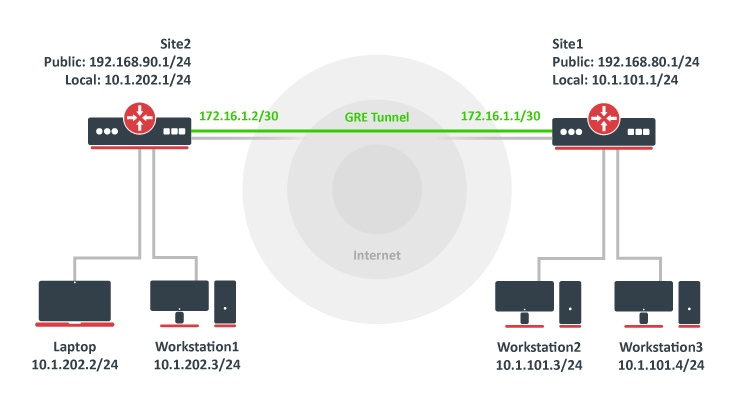

The goal of this example is to get Layer 3 connectivity between two remote sites over the internet
We have two sites, Site1 with a local network range 10.1.101.0/24 and Site2 with a local network range 10.1.202.0/24.
The first step is to create GRE tunnels. A router on site 1:
/interface/gre/add name=myGre remote-address=192.168.90.1 local-address=192.168.80.1
A router on site 2:
/interface/gre/add name=myGre remote-address=192.168.80.1 local-address=192.168.90.1
As you can see, tunnel configuration is quite simple.
In this example, a keepalive is not configured, so the tunnel interface will have a running flag even if the remote tunnel end is not reachable
Now we just need to set up tunnel addresses and proper routing. A router on site 1:
/ip/address/add address=172.16.1.1/30 interface=myGre
/ip/route/add dst-address=10.1.202.0/24 gateway=172.16.1.2
A router on site 2:
/ip/address/add address=172.16.1.2/30 interface=myGre
/ip/route/add dst-address=10.1.101.0/24 gateway=172.16.1.1
At this point, both sites have Layer 3 connectivity over the GRE tunnel.
